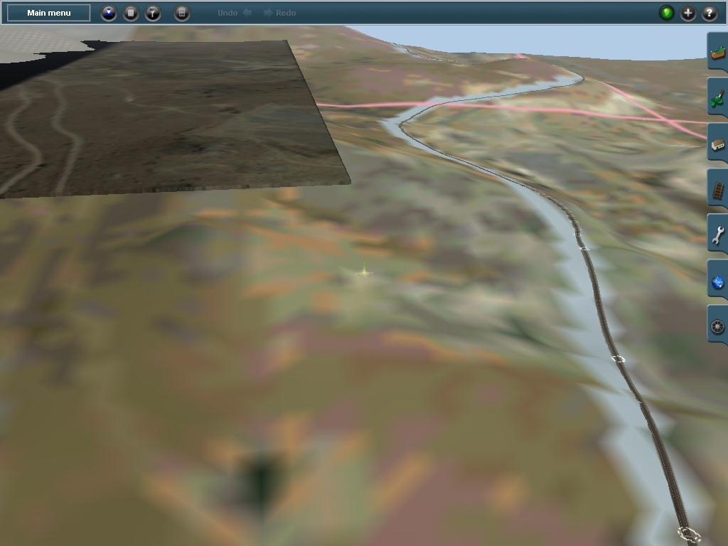

The problem is when I open the route all the UTM Tiles are floating in the air. When I go to adjust the height they don't "snap" into place. I try to adjust the height going up or down, but don't know where the UTM Tile height should be. When I adjust the height that is when the track and splines seem to be "floating. I am doing all this using the wireframe mode. How can a flat UTM Tile conform to the hilly and mountainous terrian???
The screen shot has the track "floating", but doesn't show most of the UTM Tiles "floating.
This file was done from a prnt scrn in Trainz and used in paint.
Thanks, any help you can give me would be wonderful!!!
Bruce
Re: TransDEM & Trainz
Ah, OK. Yes, the UTM tiles cannot conform to the terrain. So, you'll need to move them up and down to check the placement of items on the hills.

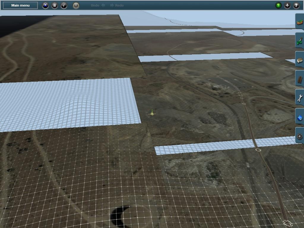

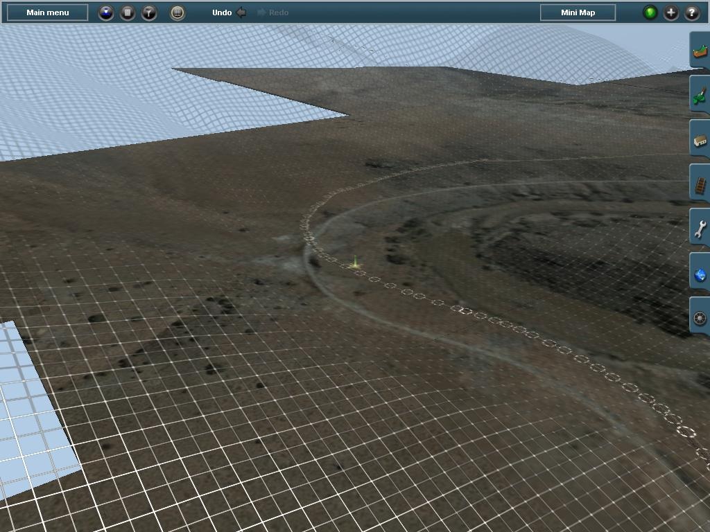

I am sorry I don't understand what you mean. I have tried everything I know in Trainz. How can a flat UTM Tile conform to a hilly/mountainous area???
Below are 2 screen shots from my route that really show what I am talking about. The first one showed the track elevated. The track seems to be "sitting" on the wireframe.
Hope you can help me with this!!
Bruce
This one shows the difference in the elevation of some of the tiles
This is just another example of a UTM tile elevated.
Hi Bruce,
The UTM tiles are just used to aid in the positioning of buildings, roads, whatever. They can't be used as the actual surface - as you say, they don't conform to the terrain.
To aid in the positioning of objects (say a house), move the UTL tile up or down until the part with the house is intersecting the grid. Then, when you place the house, place it so it aligns with the image on the UTM tile.
Does that make sense?
