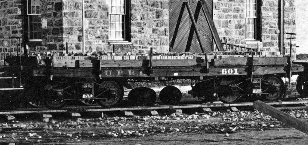

These cars share some similarities with the existing UP flat model. The car is probably a 24' with tapered side sills and "captured" end sills. This style of car was also used on the CP and may have come from the same builder. A captured end sill means the end sill fits between the side sills, rather than the full length side sill more commonly used.
UP Flat #601 alongside the roundhouse in Laramie, WY. Cropped from an A.J. Russell photograph.

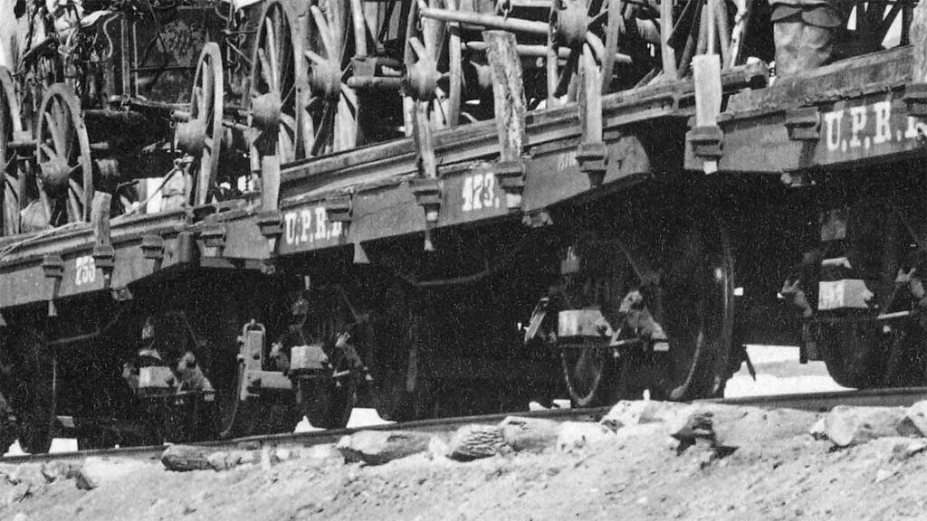

UP Flat #473 in a supply train. Cropped from an A.J. Russell photograph.
Flat #473 is flanked by sister cars #755 and #533 in this photograph. The captured end sill is visible in this view.
The trucks under these cars look very similar to the "Kimball" style truck used under V&T cars, with the addition of heavier spring planks and a leaf spring instead of the coiled spring.

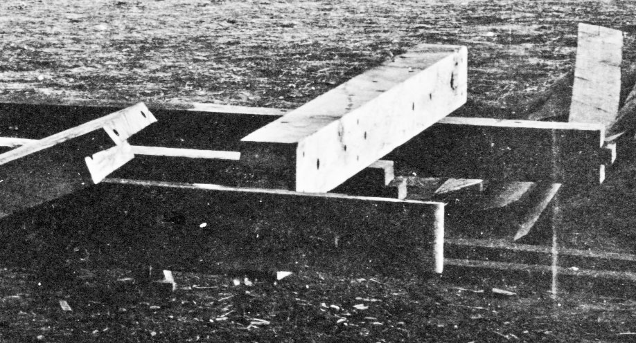

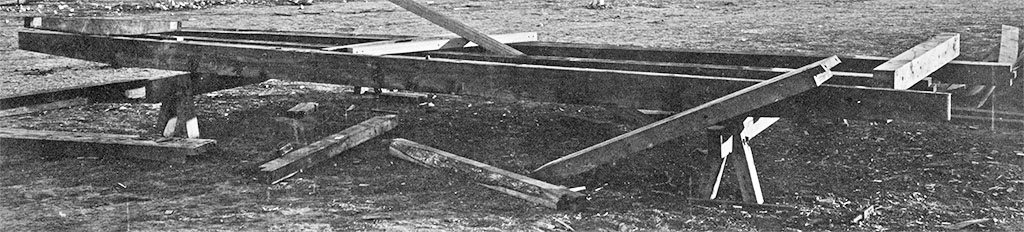

Interestingly enough, in the view of the Laramie shops, the frame of one of these short cars was being assembled in the foreground.
Frame under construction. Laramie, WY shops. Detail from A.J. Russell photograph.
The sill closest to the photographer is the outside sill, showing the characteristic rounded end used on captured sill cars. Just behind it the two center sills are visible, with the end sill resting on top. I can also spot both bolsters, the needle beams and what appears to be a brake beam.
Sill construction detail.

So do you think only 2x center sills, for a total of 4? All the flat designs I've seen have had 6x sills, including the contemporary 24' V&T flats built by Kimball. Not that anyone looks underneath these models anyway ;-)
Re: Union Pacific Flat Cars
Posted: Mon Apr 18, 2016 10:28 pm
On second look, I suspect they were six sill cars with two truss rods.

OK, thanks! The bolster design looks a little different than the Kimball version, and my brake wheel looks too big. Also, it looks like there might be brakes on only one of the two trucks, or am I just missing something?
Posted: Tue Apr 19, 2016 8:37 am

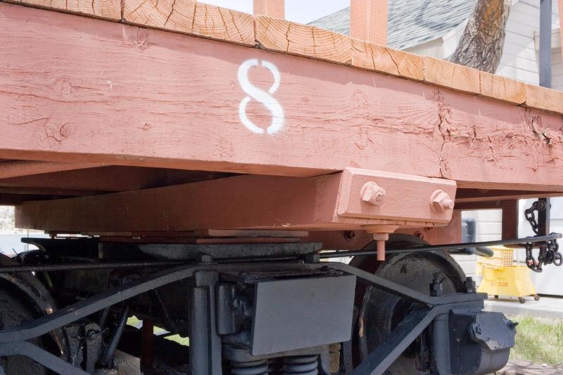

Brakes one a single truck was common in the earlier days.
The bolster design is different from the Kimball cars but more commonly used by other car builders.
Here is an example of a similar design used by the V&T on the restored B&B flat in June Lake, CA.

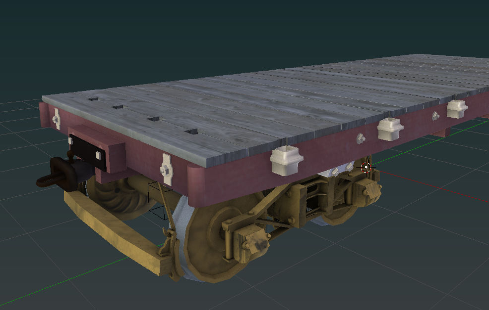

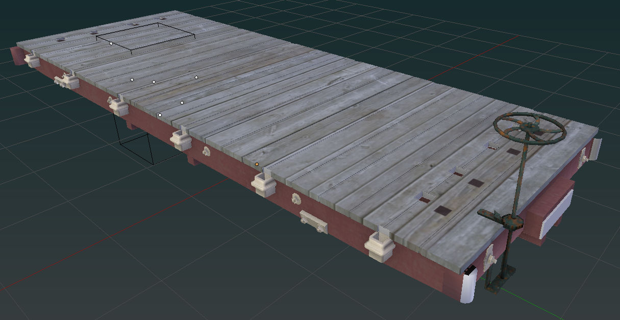

Thanks! White's freight car book has a nice drawing of a similar bolster. It appears to sit a little lower than the Kimball one; not sure if I should raise the flat so it sits on the trucks the same way, or decrease the diameter of the wheels so the truck sits lower.... I may also be able to take some height out of the truck spring planks?
Looking at various photos, it looks like some cars had two sets of brakes, and some only had one. It would make sense; one set of brakes was common during the Civil War; we're likely seeing the transition point here.
Posted: Wed Apr 20, 2016 10:15 pm
OK, making (slow) progress - the bolster is better now; as is the flat deck....
Sitting on CP trucks for now, but that too will be fixed....
