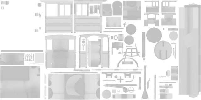

On the one steam locomotive I've done so far, I created an ambient occlusion map in 3ds max, then applied it as a translucent layer on top of my texture. That seemed to add some definition to the various parts. I also used a grey lighter than I thought was appropriate to provide some contrast inside trainz.

I use GMAX for everything except for that one experiment. Even then, all the modeling and mapping was done in GMAX - I just did the ambient occlusion map in 3ds max.
I just used a base white texture for the occlusion map, which gave me better shadow definition. I then added that as a layer on top of my real texture, using either a darken or multiply layer blend. I didn't use pure black for my texture base; I used a lighter grey. Using black just makes everything blend together; you can't see the details.
This is the map out of max; I had to clean it up a bit after this...
