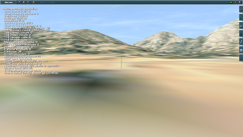

I noticed ModelerMJ's creation of a reference file and custom textures to automatically generate ground textures both on the TransDEM forum ( forum.transdem.de/viewtopic.php?f=6&t=105 ) and the Trainz forums and thought this might be a good way to paint all those distant mountains. I really don't want to do those by hand!
But, the textures he used didn't look too good on a desert map, so I attempted to create my own palate. Below is the result - both the satellite view and the view in surveyor. It's still not as good as I had hoped, but it's better than the solid color I had previously used to fill the terrain...
I'll still need to texture the foreground manually, but this should help with the background mountains (and it will be easier to navigate the satellite map with the additional landmarks...)

Yes, both those routes look spectacular. I was shooting for an semi-automatic process to get a base texture down quickly so it didn't look so bare, since it will take me *many* years to complete this route.

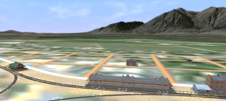

Finally got a chance to open the file. What a blurry mess and it's fantastic! This will absolutely help on locating the overall vegetation, dune, forest, roads, and you name it textures!
Most of the current roads show up which fortunately were located darned close to or on historic roads. It provides current forest cover...which fortunately has recovered to the 1880's period. There were interesting sand areas in the forested areas south of Mono those can be located!
Wonderful and many, many, thanks!

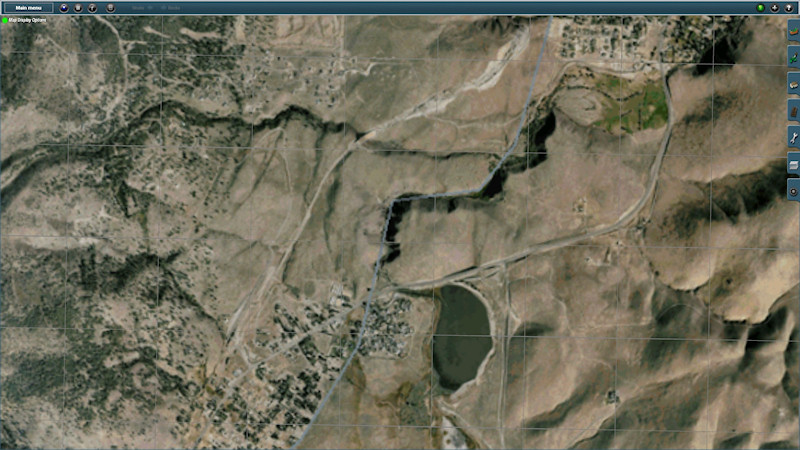

I've updated these ground textures for use in TANE (which also fixes the warnings in TS12). The updated file is at http://www.carsoncarshops.com/files/cus ... res_v2.zip. It's trainz-build 2.9 because of the required normal maps, but I've only tested them in TS12 SP1 and TANE.
Here's a shot in TANE of some distant mountains using the fixed files:

That is some excellent magic. Looks realistic enough I believe I recognize jobs peak! Looking forward to TANE
